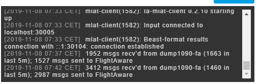

FA stopped receiving data from my device
This morning i have realized that FA stopped receiving data from my device, statistics are not updated any longer:
In the log there’s no transfer documented between 06:08 and 06:50, later transfer of data is documented after 07:00, but no data were shown until i rebooted the whole device at 07:30
Since this time it seem to be working again:
But the hourly distribution is not updating:
Any ideas what caused this?
Dump1090-fa and all the other feeders were running fine all the time.
