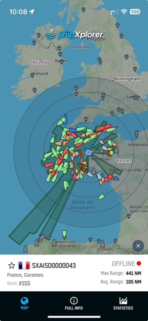

Is anyone feeding ShipXplorer and having issues with station showing as offline most of the time? All other feeds are rock solid.
Mine is reporting often as offline but is still showing ships on the iOS App and nothing in the web browser.
Support has been mute…
Fairly normal for shipxplorer.

I have 3 RPi’s feeding AIS and ADS-B. 2 of them feeding SX, I had 1 using their feeder software package and another via AIS-catcher installed using your excellant script. Both SX feeds have issues. AIS-catcher is rock solid, so is the feeds to others. The 3rd one is using AIS Dispatcher, also reliable.
I agree.
Unfortunately, the feed from aiscatcher to shipxplorer is woefully unreliable. More red than green.
S.
