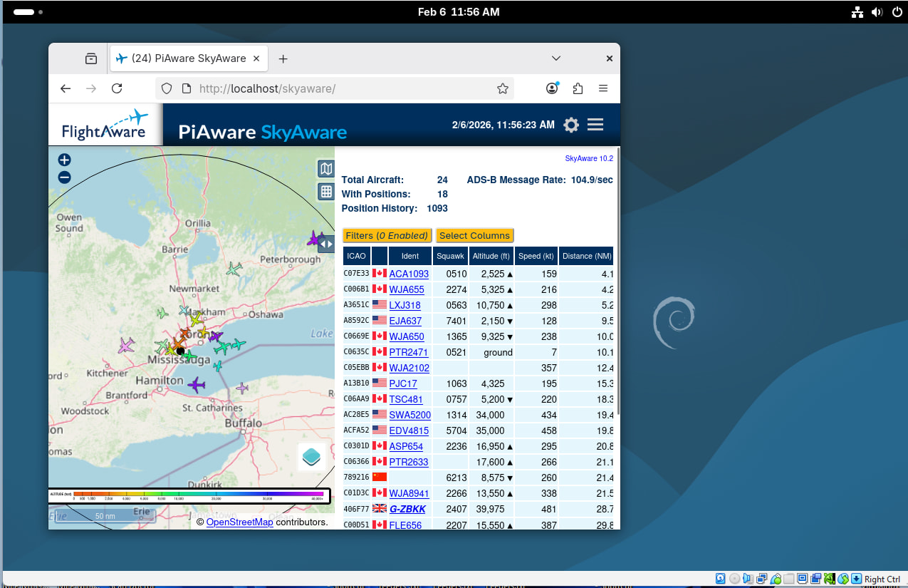

Piaware & dump1090-fa installed on RPi Model 4 / Armbian Forky using above noted commands
Click on Screenshot to See Larger Size
