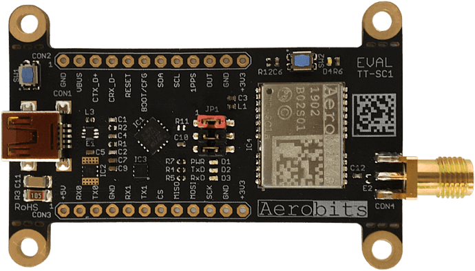

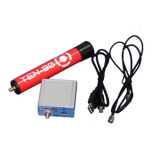

Another toy for you, not sure if anyone has tried one, uses the GNS 5894T
The GNS5894 ADS-B receiver module is the first choice for avionic applications that require high sensitivity and maximum reception range . The module is ideally suited for ADS-B feeding and other similar demanding applications. Industry leading reception sensitivity of up to -95 dBm, precise MLAT support and an unmatched power consumption of 70 mA make the GNS5894 the first choice for state of the art systems. The unique RF and amplifier design along with optimized firmware realize an up to ten times higher frame rate and double range than software defined radio (SDR) ADS-B solutions at only slightly higher cost.
That seems like a very dubious claim.

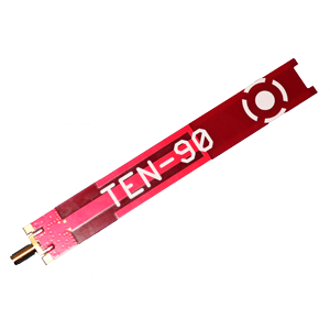

The antenna is poor compared to the Jetvision/FA antenna. I have this as a spare antenna, bought it for 29 Euro some months ago from this vendor. It has a 20% less performance than the other two i am using. So independent from how good their solution is, they are losing a lot just because they bundled this antenna.
Honestly from the inside of the antenna it looks like any other cheap antenna you get from AliExpress. I would assume any good DIY antenna outperforms that one. You can see it here, because they sell it also without housing.
Their claim regarding “gain +6 dB” is interesting, but definitely not the case.

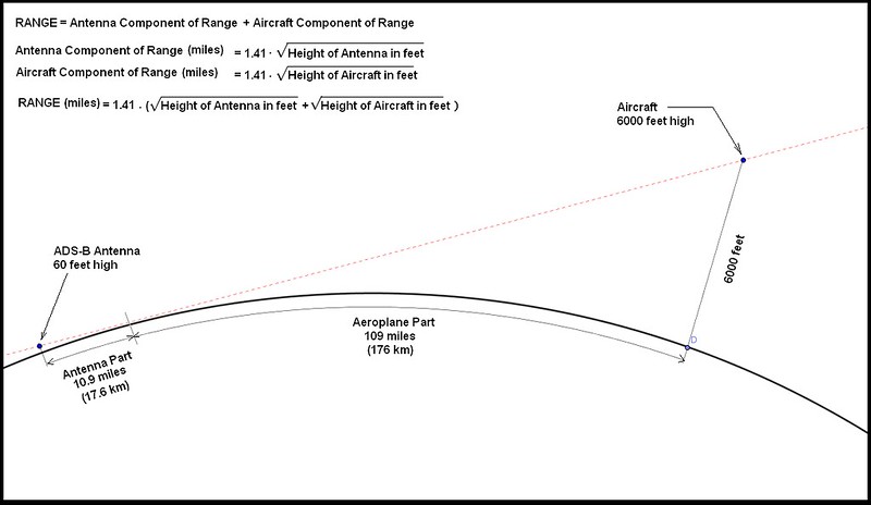

How about Tethered balloon - Wikipedia
on at least a 200 foot tether :wink:
To double the max range, a 200 feet high mast is useless.
Increase in range by raising antenna from ground level to 200 feet = (1.41√200 ) miles = 20 miles.
Increase in range by raising antenna from ground level to 2,000 feet = (1.41√2000 ) miles = 63 miles.
Increase in range by raising antenna from ground level to 20,000 feet = (1.41√20000 ) miles = 199 miles.
Playing around with Heywhatsthat.com and some different elevations from the highest tower in my area is giving me a range change of max +30 miles
I picked a figure at random, 200ft or 20,000ft, neither is going to happen.
Yes, I knew what you meant.
I posted it for those who think that increasing antenna height will increase range appreciably. This is true only up to the height of surrounding obstructions. Once the antenna is above the obstructions and can see horizon, any further increase in antenna height is a waste of money & time.
Probably refers to signals dropping out at close range due to poor dynamic range.
The module itself looks interesting. It’s a hardware decoder so might work well. I haven’t seen any reviews of it yet though.
Also no reviews of Air!Squitter. I don’t know the details, but there might be a hardware decoder on it as well.

Here is the datasheet on the other unit mentioned above. Interesting…
What I really find interesting so far as new toys is concerned is the Raspberry Pi Hat they show on this page:
I don’t see it in their store, but it’s interesting considering the GNS5894 specs
ADD: Link I found aber nur auf deutsch:

Hey I’m just sharing what I saw - The claims seem pretty outlandish.
The “dev kit” just includes one of their antennas I assume so the user can just start experimenting.
The main part of the kit would be the box which has their chip ready to hack on. Otherwise it looks like you could buy their chip and design a board, and do a bunch of prototyping before you can try it out. Unless you can find tha adsb pi hat.
Anyway, never heard of them before and price is $$$ so figured it fit in the expensive toy cataegory :wink:
