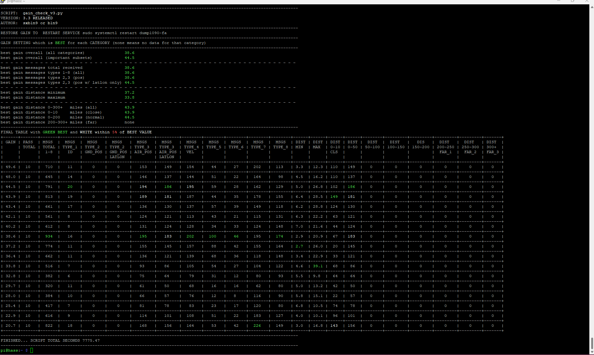

I have run this script on my setup. Below is what it has given (I am still using the Nooelec NESDR Mini):
What should I do with this information? Asking for other novices.
Disregard, I was using wrong port.
glad to hear you got it sorry about the delay in my response there.
hey so since you don’t have a lot of planes around you at the time you ran this, I would ask you to run it again in general when you have more planes like 2-4 pm in your timezone. I would also suggest you run more passes or longer passes or both.
Like 30 seconds a pass and 10 passes on the gains.
This will allow the data to normalize better so the picture will be more clear.
However according to the data you got it looks like you should set your gain to 32 and turn off adaptive gain and burst.
