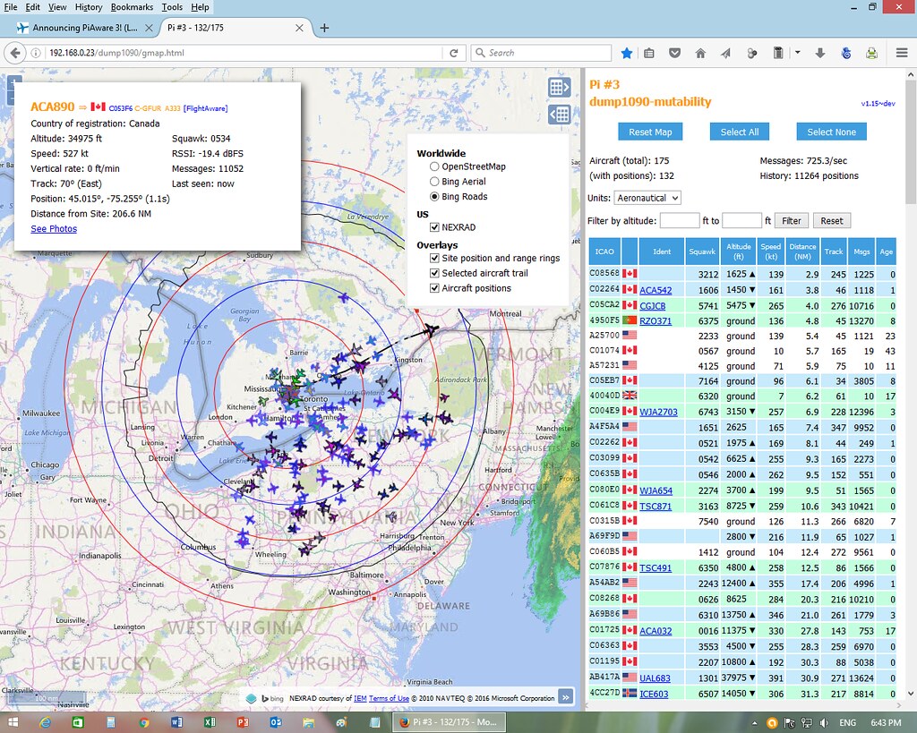

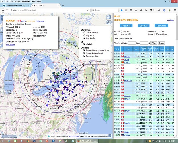

In dump1090-mutability 1.15~dev, with skin of Piaware 3.1.0/dump-fa, another minor modification (title block text). Please see modified title text on top-left of aircraft table.
  1. /usr/share/dump1090-mutability/html/config.js: Modified variable PageName = “Pi #3” and added new variable PageName1 = “dump1090-mutability”.
  2. /usr/share/dump1090-mutability/html/style.css: In infoblock_heading added color: orange,
  3. /usr/share/dump1090-mutability/html/script.js: in function initialize(), added line $(“#infoblock_name1”).text(PageName1);
  4. /usr/share/dump1090-mutability/html/gmap.html: In
    , added one table row dump1090-mutability.
