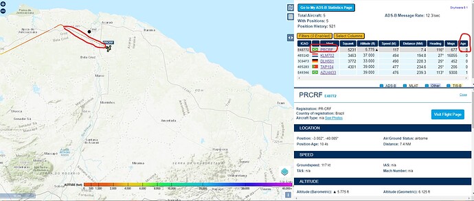

Hello everybody! I have a question that has been taking my patience away for a while. I have noticed that in some situations where, even with a good or reasonable signal, my flightfeeder does not receive the aircraft positions. I don’t know what to do to resolve this, if it’s even possible. Has anyone gone through this?
Sometimes it happens that the aircraft disappears for a while and then reappears, leaving a dashed line in the skyaware. That’s right with a good signal…

Can you add the signal levels to the screen shots? The most likely culprits are building/terrain shielding or signal overload.
Obrigado Jonhawkes2030. There is no obstruction. The sky is clear around the antenna.
In the first image the signal is at -2.4dBFS. In the second photo I didn’t pay attention to the signal level, but it was certainly good as the distance was less than 7 miles during much of the dotted route. This type of situation happens a few times a day, with some aircraft, not all…

Hello. It seems that the problem is the signal level. This time, I tracked the same plane following the same route, leaving from the airport near here (Jericoacoara/10NM) and there were improvements regarding the loss of ADS-B positions.
Note that there are fewer dashed lines when I compare the image above (most recent) with the image below.
