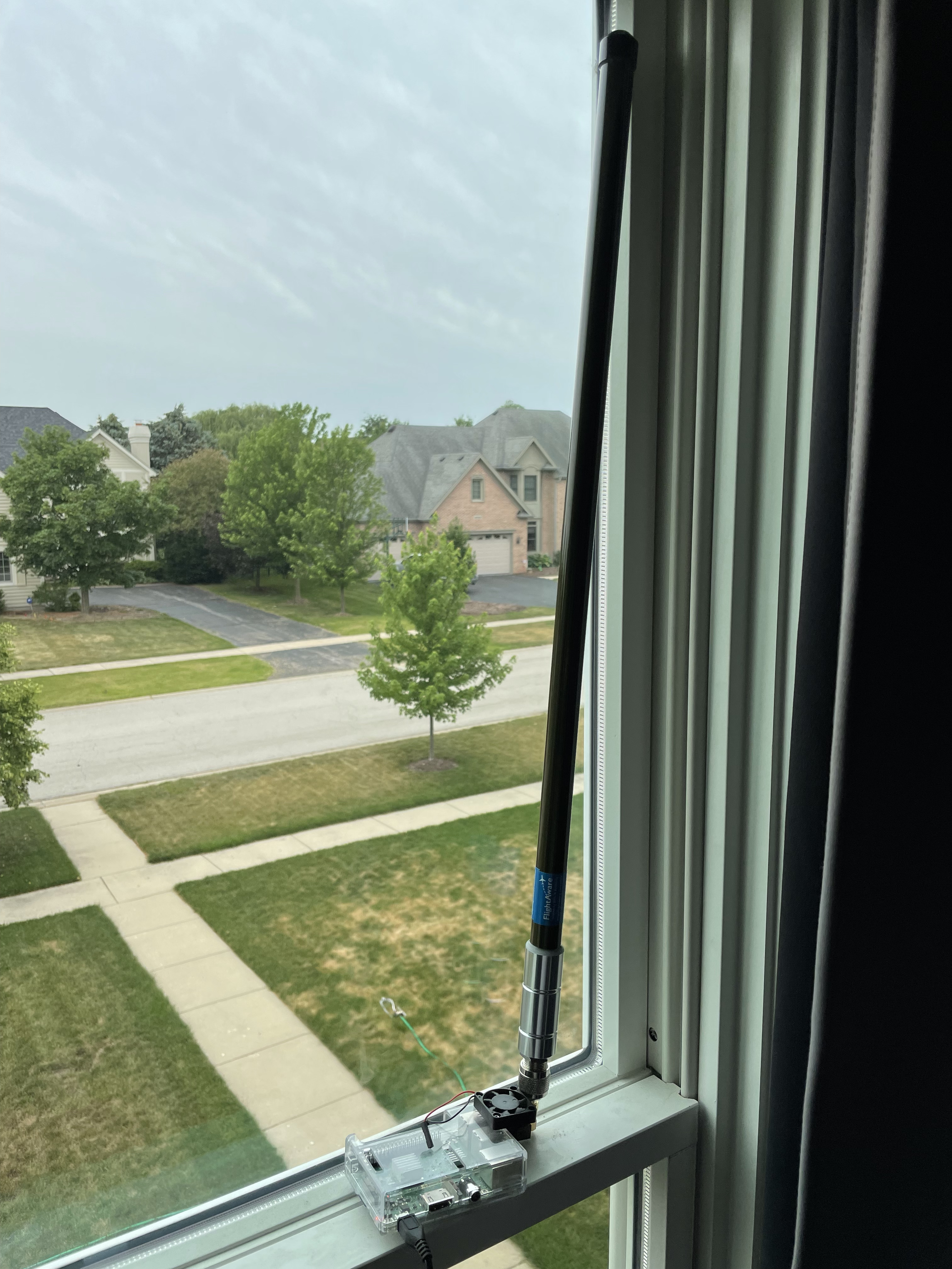

Your main issue are the antennas, having them so close together is what reduced the performance.
Also the fan wouldn’t be an issue if it wasn’t directly next to the antenna.
Well could also be that it’s feeding back through the 5V rail because the SDRs aren’t great.
Build yourself some quarter wave antennas that can be place at least a foot apart and a foot above the pi.
QUICK SPIDER - No Soldering, No Connector
You can just make it a bit longer for 978 but it’s not that critical anyhow with this type of antenna.
Would improve your reception a lot.
What is your fly-screen made of? (is it metal?)
Without moving anything else, can you open the screen to see if there is any change?
Some ferrite beads on the fan leads might help. Also, use a dunny roll core as an air-duct to get the fan further away from the radios.

Thanks- when I saw how those pictures came out, I pulled the screen off to test. It really didn’t make much of a difference - I don’t believe it’s a metal screen. I had ordered this antenna and added it to my setup last night and it seemed to made a big difference. I’ll probably have to wait for Monday to see a lot of traffic and see what range I have.

Couple of suggestions.
The aluminium between the glass planes is very close to your new antenna and may be degrading performance.
The big antenna may be putting a lot of load on your connectors and may break one if it falls over.
Try tying a string to the top of the antenna and hanging it in the middle of the window
