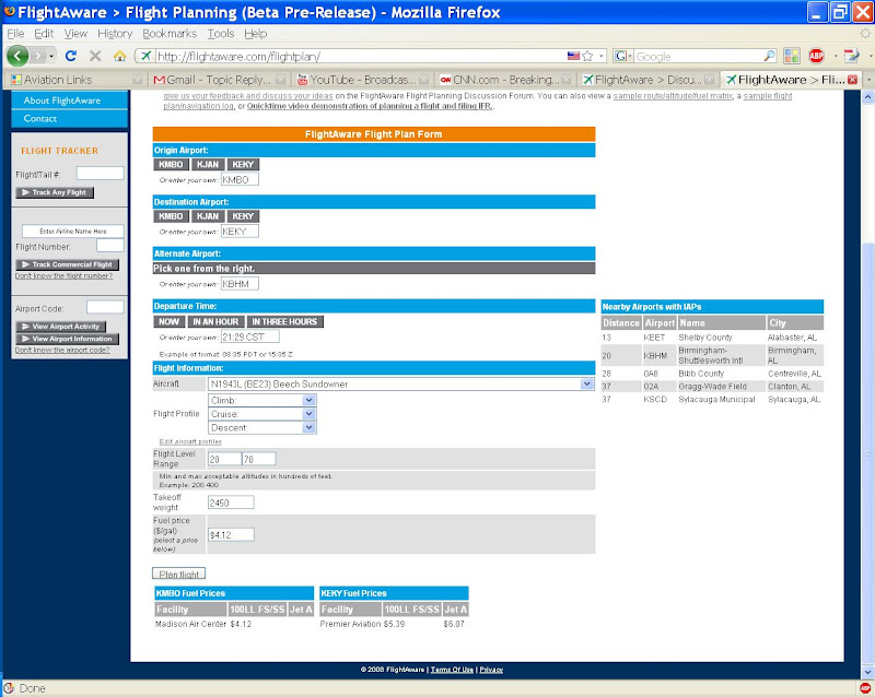

Error ID: 665153 being encountered as of 5:54 p.m central time. for flight planning.

Unable to find a valid cruise altitude within the limitations of what you specified in the form, available performance data, and elevation of origin/destination.
What were you trying?
Entered 20 and 70 as lower and higher flight level limits.

What was the origin/destination and aircraft cruise profile? PM me if you don't want to say in public.
No problemo in public so others can learn from most likely "user error" on my part :)
Below image were my input values.
Tried just before posting and error ID is now 0 rather then 665153

Mark,
Hadn't heard anything so I tried again, deleted my cruise profile and set it higher then my proposed flight plan just in case that was causing a problem. (both were equal to 7000 so I changed my cruise profile to 8000)
Error code returned 670765
I picked a public aircraft profile and it worked so it has to be something wrong in my setup?

We don't really understand the root cause of either of the errors you've managed to produce; they just shouldn't happen.
Can you email or fax in a copy of your POH performance data and we'll be happy to enter it all in for you? I think the root of the error may be related to your single point performance data.

Your performance data is still the issue; it needs a range to interpolate over. And now I've lost your POH. Can you fax it over again?
